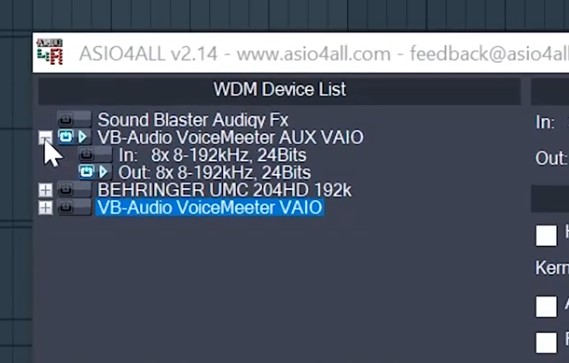

How do I substitute the routing from within ASIO4ALL with only Voicemeeter Potato:
Anmerkung 2020-03-25 091126.jpg (35.21 KiB) Viewed 25570 times
Posts: 2214
Re: ASIO4ALL in certain sitiations needed?
what application is using ASIO4ALL driver ?

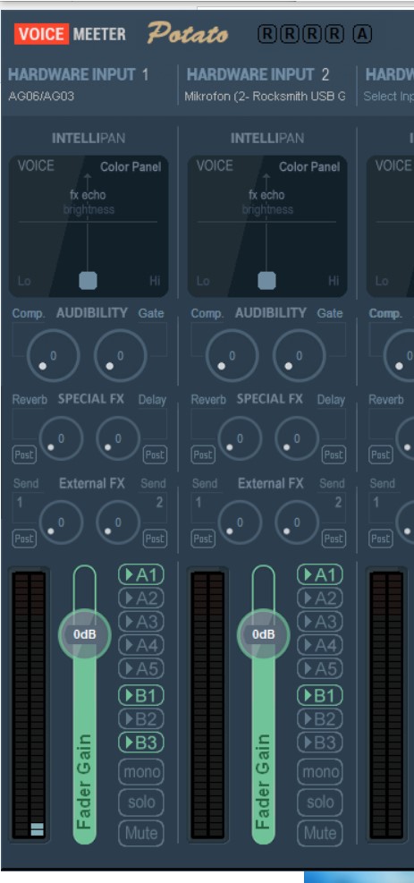

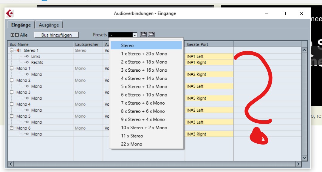

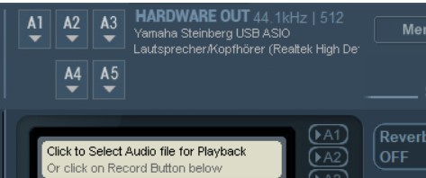

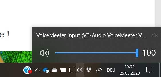

Post by adrian142 »
ASIO drivers are used by: Cubase AI DAW, Yamaha AG06 mixer (with two separate channels (one for guitar, one for voice)).
I am not able to get the right Voicemeeter channels selected.
Here it is step-by-step:

Posts: 2214
if you use the virtual insert ASIO driver, you may activate channels one by ones in the system settings dialog box PATCH INSERT
