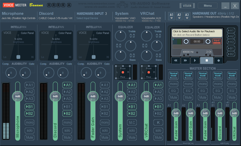

Hi. ¿Could you post a screenshot of Voicemeeter Banana to see how everything is connected?

Here, the Foobar audio player transmits sound to VrChat and Discord via VoiceMeeter AUX at normal volume, and transmits sound to the headphones via CABLE Output with a reduced volume level (-7.9).
If I change the Output device in Discord from default to VoiceMeeter AUX Input, then VrChat's participants hear Discord's participants, but Discord's participants hear the echo of their voices.
Alternative virtual cable Line 1 (Virtual cable) in HARDWARE Input 3 is not involved now and I do not know if it can be useful to me.
Can I solve the problem with Voicemeeter Banana or I need a third VIRTUAL INPUT in Voicemeeter Potato?

Hi. You need one output to send audio to Discord and a different one to send audio to VRChat (It seems like you are currently using B1 output = VoiceMeeter Output in both programs). Your options include:
  • Use B2 to send audio to Discord: Are you currently using B2?
  • Use Line 1 (Virtual Audio Cable) to send audio to Discord: This requires to remove it from Hardware Input 3 and selecting Line 1 (Virtual Audio Cable) as your Input Device in Discord
But you also need to use an audio input to receive audio from Discord and a different one to receive audio from VRChat (Apparently you are currently using VoiceMeeter Input (VB-Audio VoiceMeeter VAIO) in both programs). You can use Hardware Input 3 to receive audio from Discord; this requires a Virtual Audio Cable.

Andreas, Hi, and thank you very much for your help!
According to your instructions, I tuned and tested the sound on two computers and now everything works perfectly.
Indeed, B2 was not used, and now everything is involved.

Andres wrote: Fri Sep 11, 2020 8:46 pm screenshot
VRChat:
Re: Is it possible to transfer sound between Discord and a video game?
Posted: Wed Sep 16, 2020 2:45 am
Hi. I can't find a solution using only Voicemeeter Banana. Connecting Skype requires an additional virtual input and output which is not available. Using an additional Virtual Audio Cable you could try a more complex setup but I think you should try to simplify your setup instead of adding more components to it. If you depend on Voicemeeter Banana I could try to describe this alternative. Please let me know.
