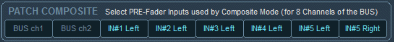

Hi. In Voicemeeter you can select the COMPOSITE mode for virtual outputs (and hardware outputs) to "compose" the 8 output channels from the different input channels.
composite mode.png (4.96 KiB) Viewed 21752 times
Voicemeeter Banana and Potato provides the PATCH COMPOSITE section in System Settings / Options... windows. You can compose your signal PRE- or POST-Fader
patch composite.PNG (142.31 KiB) Viewed 21767 times
In Voicemeeter Basic patch composite is fixed and only PRE-fader.
For more information see Voicemeeter Banana User Manual, page 19.

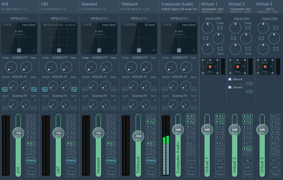

Thanks for the answer, my apologies for missing it for so long. I've tinkered with the Patch Composite settings, but I still seem to only get any signal on the 1 and 2 channels of the virtual ASIO device. I'm either not understanding how this is supposed to function, or its function isn't what I'm looking for.
In the below example, say I want to route the 416 to channel 1 on the Voicemeeter VAIO ASIO device, the U87 to channel 2, the Headset to channel 3, the talkback to channel 4, etc. Is that possible?

Hi. Try the following settings in PATCH COMPOSITE:
Since you are sending the four inputs to B1, remember to set B1 output in Composite mode (Master Section). If you want to preserve the fader settings of each input use POST-Fader in PATCH COMPOSITE.
