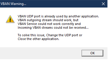

Hello, I'm trying hard to connect the new (beta 3.0.2.0) VB-Streamer to control the volume of a remote computer. Using local config works well but when I change to a remote IP I get "Voicemeeter is not responding to VBAN#1" and got this MSG

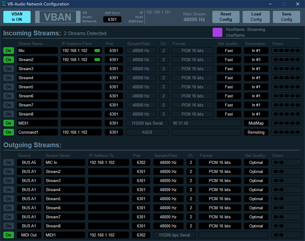

Potato VBAN Config LOCAL.png (86.94 KiB) Viewed 31680 times
I also tried to change the port on both computers to something else like 6301 and I got audio streaming, macrobuttons with midi working but not the streamer-view.
AM I doing something wrong? Help Please!

if you run the streamer view to use it with VBAN connection, you may shutdown VBAN on Voicemeeter because on a given computer, 2x applications cannot use the same UDP port.

by Jubis_1963
Fixed! Thanks...
Found out that I can set separate ports for outgoing! So I changed computer with IP 192.168.1.101 to send at 6302 and computer 192.168.1.102 to send at 6301. that did it.
VBAN FIXED.png (88.52 KiB) Viewed 31675 times
But the VM-Streamer besides ON isn't controlling the audio on the remore computer!
Can I set # ports for incoming? I tried to change one but when I do they change for all Streams!
Thanks

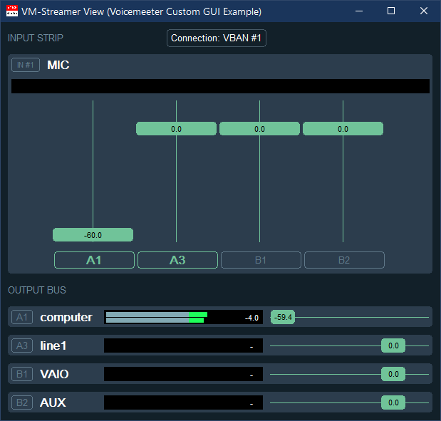

Justto illustrate what I said, connection OK but controll not working. I zeroed the MAIN (computer) and the sound was still full.

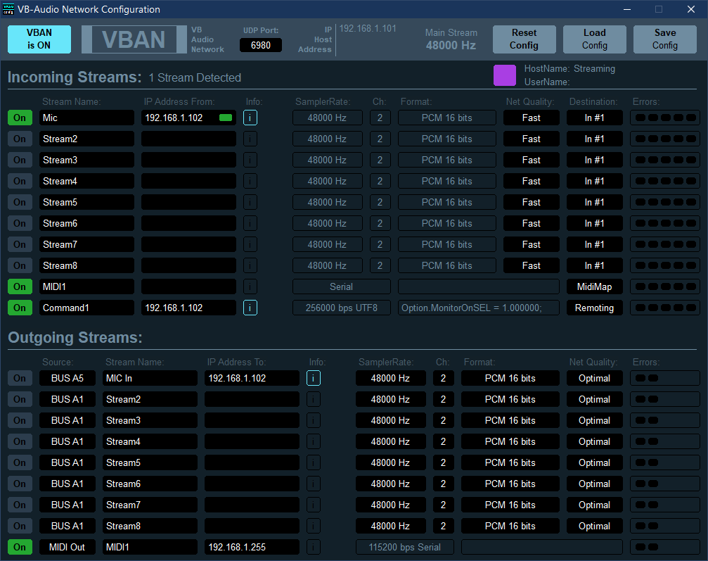

Re: NEW VB-Streamer not connecting to remote computer
Posted: Wed Oct 20, 2021 3:13 am
by Jubis_1963
Made it to work just renaming Command1 to somtehing else! It WORKS! super
