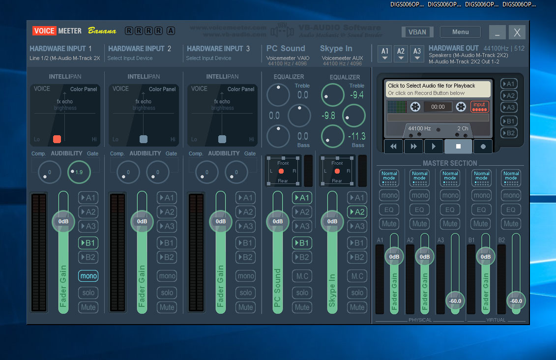

Hi there.
I've been using Voicemeter (Banana) as a way to work collaboratively over the web, using Cubase and skype/google hangouts.
But I have run into a slight issue (not a massive one, but would just like to check I am not missing anything obvious)
I have HW input 1 set to the line in for my mic, and I route that to B1
I have VAIO1 (Voicemeter VAIO) as my main pc sound for applications I set to output to it (so Cubase, media player, chrome etc) and have that routed to A1 and B1
I have VAIO2 (Voicemeter Aux) set to be the skypr of hangout autput, routed to A2.
So basically, I hear A1 and A2, and the person at the other end, just hears B1 (A mix of my pc sound and my mic)
When I go to set the outputs for A1 and A2 though, If I select "ASIO : MAUDIO Mtrack 2X2) << i.e. my devices main asio driver...I get no output.
I have to select KS, or WDM drivers for those outputs to make it work.
So it works fine, but I'm wondering if I am getting the best performance (cubase latency, asio performance etc) by not being able to chose the maudio's asio driver as an output.......or does it not really matter?
have attached a screenshot of my current mixer frontend if my writing above doesn't make sense.
Cheers
Mark.

- A shot of my current mixer
- MyVM-audio-settings.jpg (193.74 KiB) Viewed 26485 times

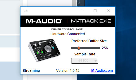

As for their control panel.. it's very barebones, just a buffer slider, and a monitor to show if it's "streaming" audio or not. As far as I can tell (unless something weird is running in the background that I don't know about) I don't have anything running that could be stealing the audio device.
