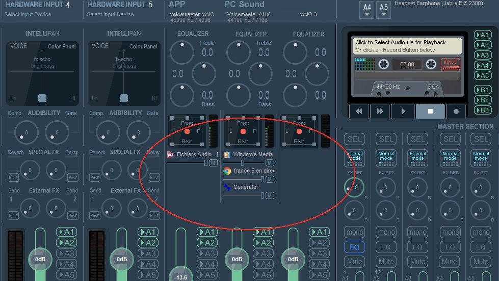

Voicemeeter8 (a.k.a. Potato) is available now as Preliminary Beta Version 2 to validate last corrections (most of them related to the different reported bugs here) and test the very new promising feature showing connected application on virtual inputs (1 and 2 …).
PRE-REQUISITE: to have Voicemeeter Banana 2.0.4.1 already installed.
In this preliminary version, we are missing some features: no internal Delay FX, no VAIO-3, no External AUX and the Virtual ASIO Insert driver won’t work correctly (some DLLs will have to be changed, it will be done in the next coming version included in a complete installation package).
