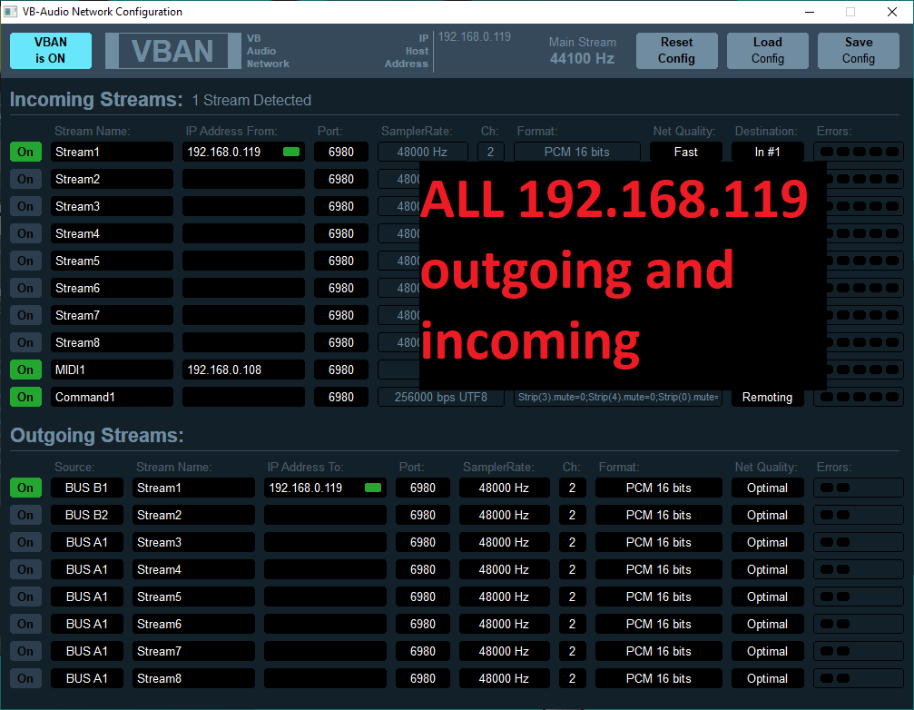

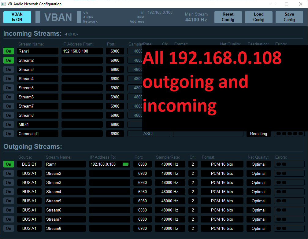

Im back to tackling this because it seems using the .255 to broadcast is having negative effects on the rest of my network.
this time I've noticed that I'm getting the error for "underrun" on the incoming stream. but only if I set the outgoing stream to .255, and then to the proper address of .108
I'm not sure why the audio stream would be coming in too slowly, but now I have to fix this or not be able to continue using vban
- main119.png (73.51 KiB) Viewed 41129 times
- main108.png (68.93 KiB) Viewed 41129 times

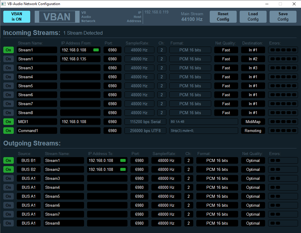

This is what still bothers me the most about this situation. from my first post "I tried sending an Outgoing stream back to the same PC, and it doesn't even recognize that."
what would be preventing the stream from being sent to the same pc? if I can get it to receive from itself it will hopefully allow it to receive from other computers on the network as well
- none108.png (77.82 KiB) Viewed 41125 times
- 1stream119.png (85.02 KiB) Viewed 41125 times
