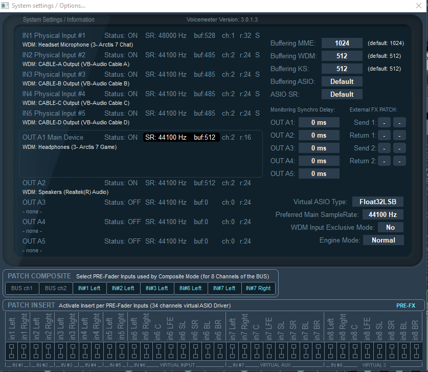

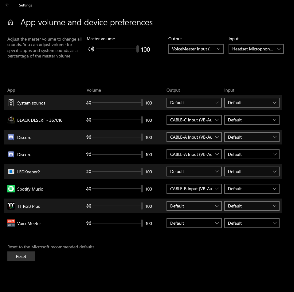

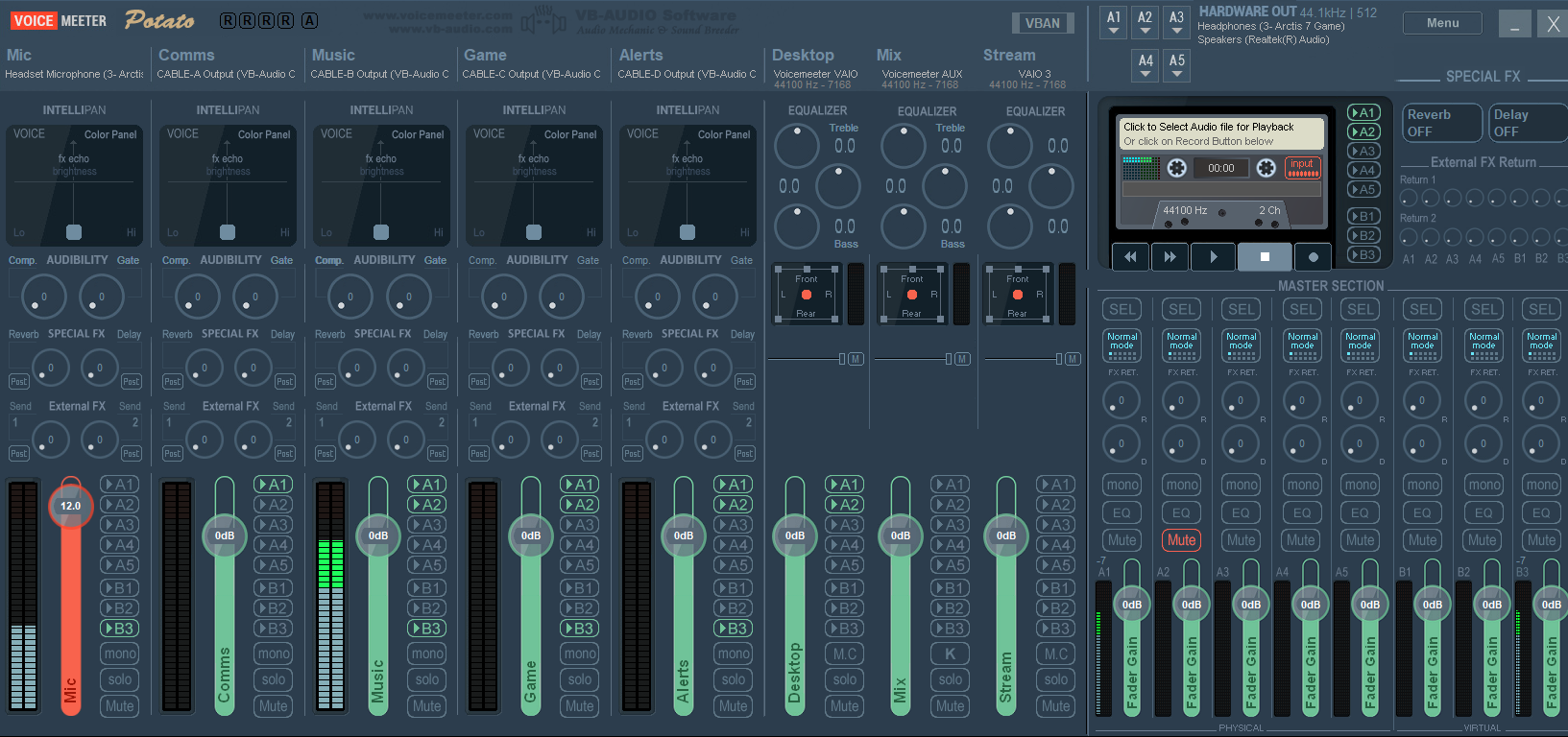

I have VM Potato and audio cables A,B,C & D. All my hardware inputs are all set WDM outputs. All of my programs are set to the corresponding cables in windows audio settings. A1 is my headset and A2 is my soundbar. I've attached a few screenshots of my settings. If there are any other ss that could help troubleshoot this, let me know and I will attach.
So I will try to explain this as best as I can. My mic works fine, Spotify(Microsoft Store Version) works fine, Discord works fine, Streamlabs OBS works fine but Black Desert Online, League of Legends, Call of Duty Warzone and Terraria do not. Discord is on Cable A, Spotify is set to Cable B, all of my games are set to Cable C and Streamlabs OBS is set to Cable D. In order for my game audio to work, I have to go into windows audio settings and set the output back to default and then back to the corresponding audio cable. Once I do reset them, so to speak, they work fine. Should I restart my computer or if the program is closed and reopened, I have the same issue again. Discord, Streamslab OBS and ALL my games are set to launch as administrator, I've tried not running them in administrator as well and unchecking launch as administrator and launching them manually as administrator with no luck. I have been dealing with just manually resetting them every restart or game crash but if they could just launch and work properly, that would be ideal. Thank you to anyone who can help me.

my playback device currently is Voicemeeter Input (VB-Audio Voicemeeter VAIO)
The problem is that every single time I launch a game, I have to go into settings>sound>app volume and device preferences and switch the game output from Cable C back to default then back to Cable C to get it to start working. It doesn't work straight from the game launch. This happens to every game I play. I can record a video, if that would help and post the link here.
