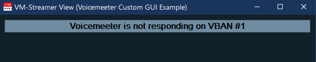

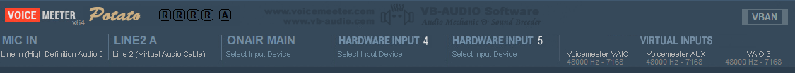

Hello, I'm trying hard to connect the new (beta 3.0.2.0) VB-Streamer to control the volume of a remote computer. Using local config works well but when I change to a remote IP I get "Voicemeeter is not responding to VBAN#1" and got this MSG
vban error.png (8.89 KiB) Viewed 35271 times

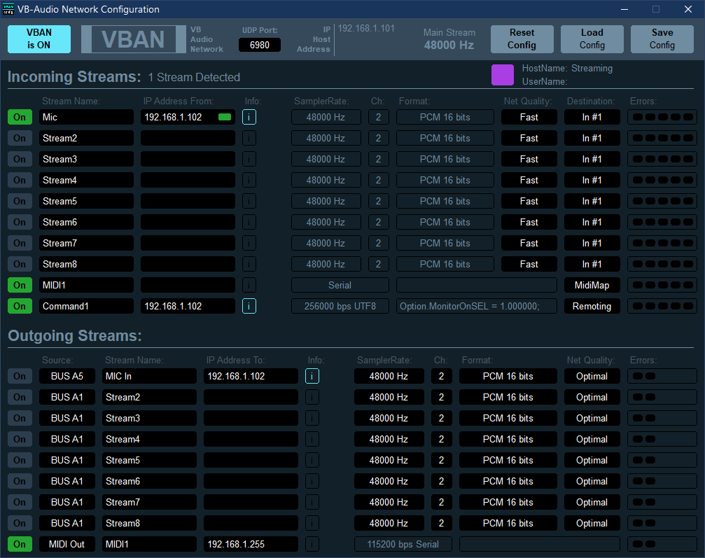

My configuration is:
Local computer ip:192.168.1.101
remote computer ip:192.168.1.102
Potato VBAN Config LOCAL.png (86.94 KiB) Viewed 35271 times

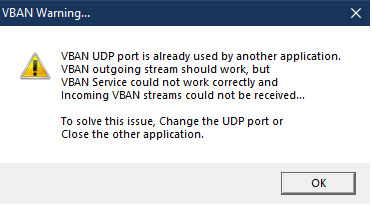

I also tried to change the port on both computers to something else like 6301 and I got audio streaming, macrobuttons with midi working but not the streamer-view.
AM I doing something wrong? Help Please!
Thanks

if you run the streamer view to use it with VBAN connection, you may shutdown VBAN on Voicemeeter because on a given computer, 2x applications cannot use the same UDP port.

I turned VBAN off on voicemeter
VBAN Off.png (31.83 KiB) Viewed 35266 times
on both computers, turned off Macrobuttons on both too
and still can't connect, only locally!

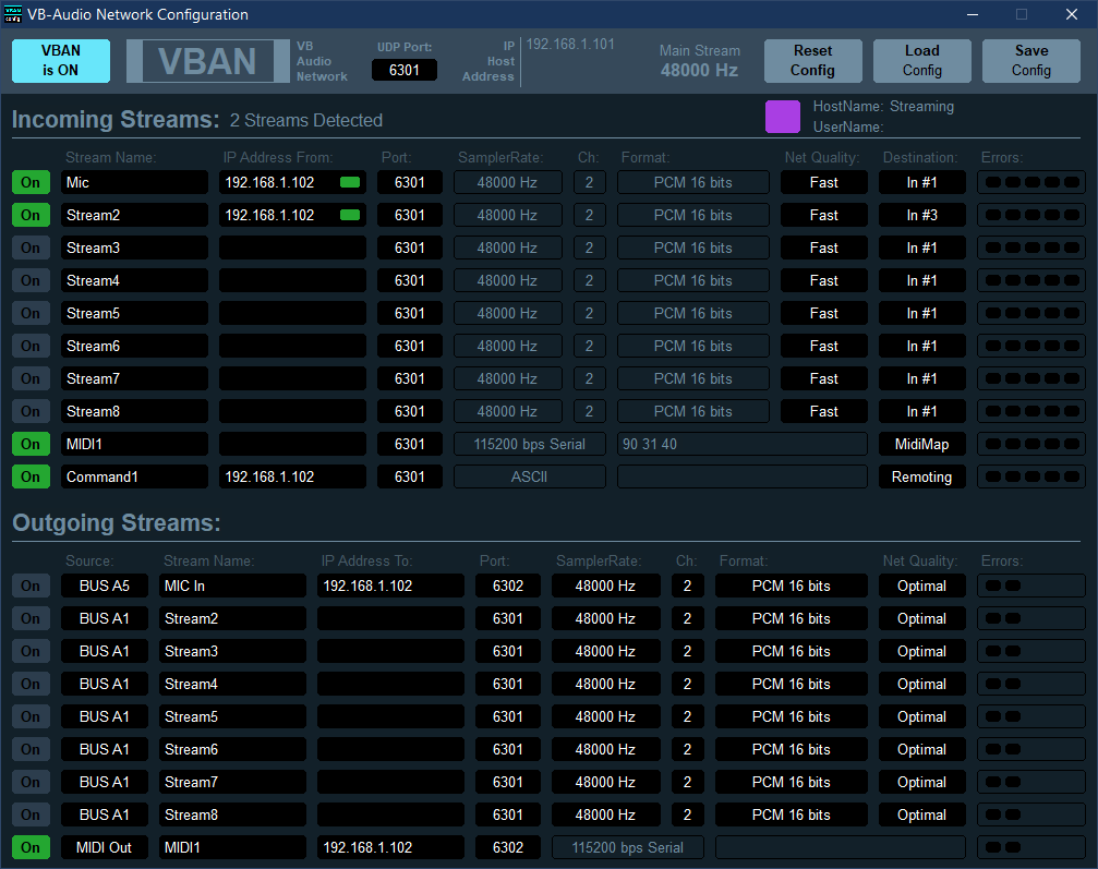

Fixed! Thanks...
Found out that I can set separate ports for outgoing! So I changed computer with IP 192.168.1.101 to send at 6302 and computer 192.168.1.102 to send at 6301. that did it.
VBAN FIXED.png (88.52 KiB) Viewed 35266 times

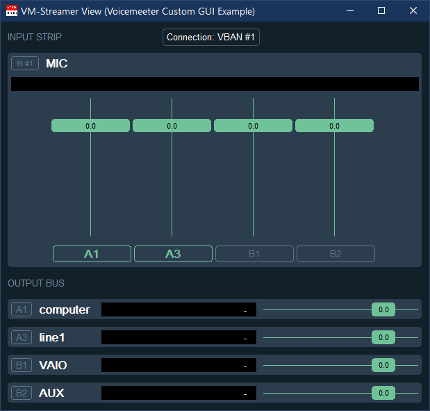

But the VM-Streamer besides ON isn't controlling the audio on the remore computer!
Can I set # ports for incoming? I tried to change one but when I do they change for all Streams!
Thanks
VB Streamer ON.png (16.79 KiB) Viewed 35266 times

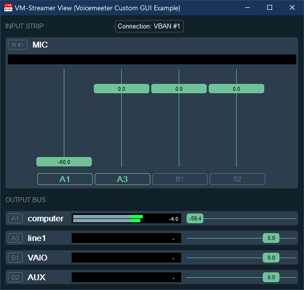

Justto illustrate what I said, connection OK but controll not working. I zeroed the MAIN (computer) and the sound was still full.
VM_Streaming OK but not working.png (17.76 KiB) Viewed 35255 times

Made it to work just renaming Command1 to somtehing else! It WORKS! super
