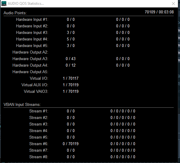

OK, I'm not sure if this tells us anything or not but this is the QOS on 134 (the one with no incoming green bar showing).

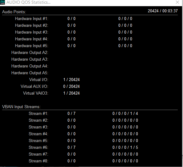

And the one with 136 (which is working)
I noticed a high second number on VBAN incoming streams on 134 Steam #6. Much higher than the numbers oon stream 1 of 136.
I also looked at wireshark UDP packets with port 6980 and it looked like everything aligned with the documentation on VBAN (but I'm no expert). If you want me to post a capture log, I can do that.
I also de-installed and re-installed VM on 134. Do you think there could be a corrupt registry entry there?

no, there is a problem with something related to your network on PC 134
QOS data are interesting to check error frequency coming on running stream...
but while the VBAN will display 'no stream detected', it means we have a problem on network level...
if wireshark see incoming VBAN packet (possibly a hundred packet per second), it means your PC is receiving the VBAN Stream, but not the Voicemeeter application, then it could mean the problem is around firewall/antivirus/networkquota/privacy settings... i don't know.
