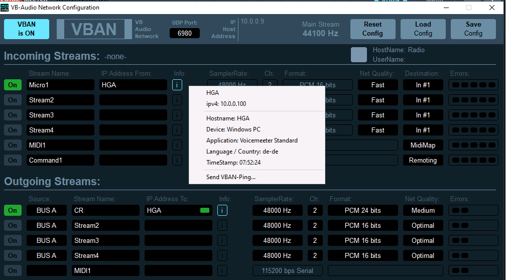

This is the computer which sends the outgoing streams
This is the computer which sends the streams

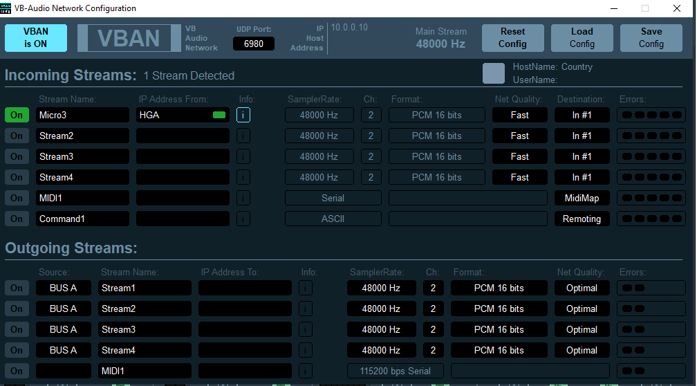

This is the computer, which cannot detect the incoming stream
This is the computer which does not detect the incomming stream

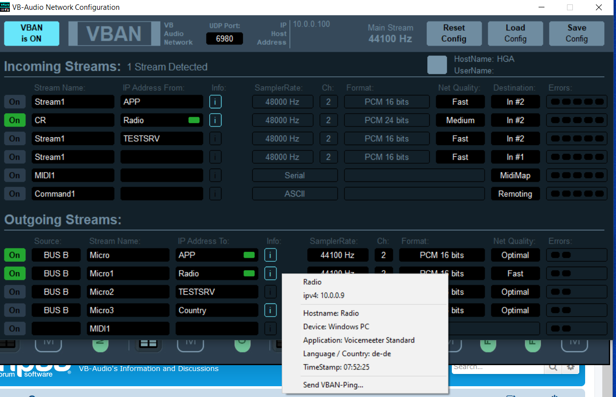

This is the computer which detect the incomming stream
Vincent, thank you for the support!
If you need additional information, please let me know, Hans-Georg
