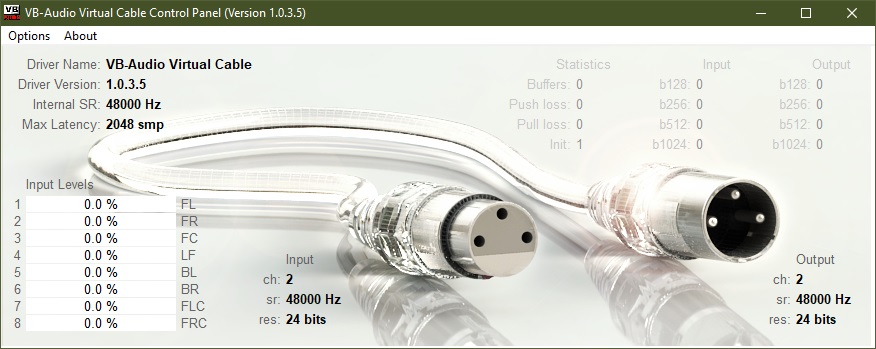

Hello, I am trying to use the VB-Cables as part of my livestreaming setup. I decided to do all my audio processing in Ardour. I use 3 vb-cables in total:
  1. VB-Cable: To send the processed audio from Ardour to OBS
  2. VB-Cable A: To capture desktop audio and send it to Ardour
  3. VB-Cable B: To capture background music (specific applications) and send it to Ardour
I also use a UMC204HD audio interface for my XLR microphone and headphones.
I tried livestreaming with this setup and I encountered audio distortions maybe once every 20-30 minutes. They gradually fade in and out, over the course of about 2 minutes. I suspect that the issue may be the UMC204HD audio interface's clock being asynchronous with my PC's clock resulting in clock drift and causing distortions, but I'm not really sure, neither am I sure about how to troubleshoot this issue.

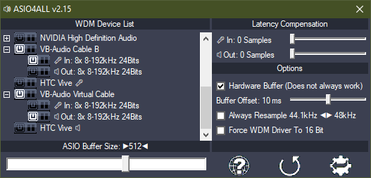

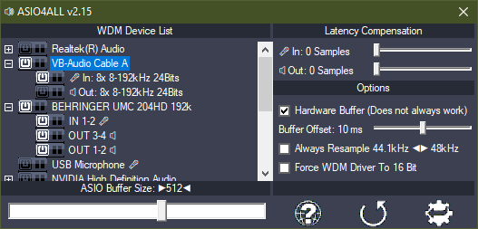

In order to access my UMC204HD audio interface along with the VB-Cables from Ardour, I am using the ASIO4ALL driver.

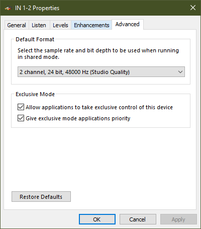

I made sure to set all my devices to use the 48 kHz sample rate, 24 bit format. Here's one such configuration of my microphone:
My ASIO4ALL configuration is as follows:
(continued in next post, because I can't embed any more images)

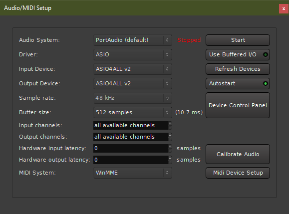

My Ardour configuration is as follows:
All of my VB-Cables are configured the same way:
The buffer size is 2048, which is more than 3 times Ardour's buffer size (512), so I believe that should be fine.
