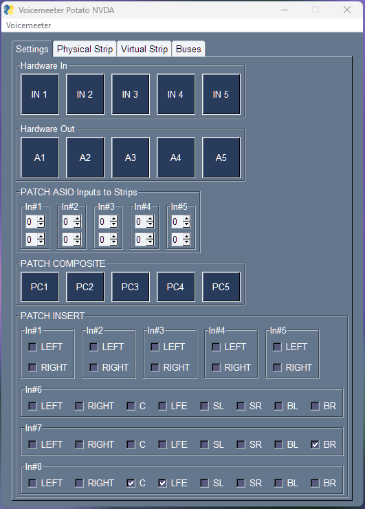

There is now a first solution called NVDA-Voicemeeter providing an accessible interface for blind people using NVDA:
https://github.com/onyx-and-iris/nvda-voicemeeter
