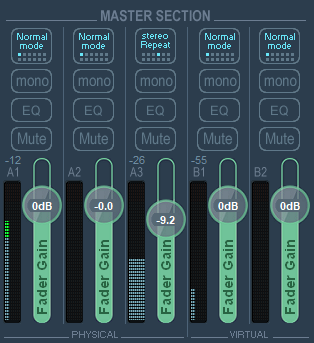

Yeah thats indeed surprising, I am glad I found that out once more reaching out to you guys, really appreciate it...
Just one more little question: When I want to listen to music I noticed it will only output to my front speaker. Then I found the "Stereo Repeat" button and I am getting the music directed to all 6 channel now! Just wondering if this isnt going to hurt the satelite speakers cos it sounds that there is a lot of bass being transmitted to them as well?!

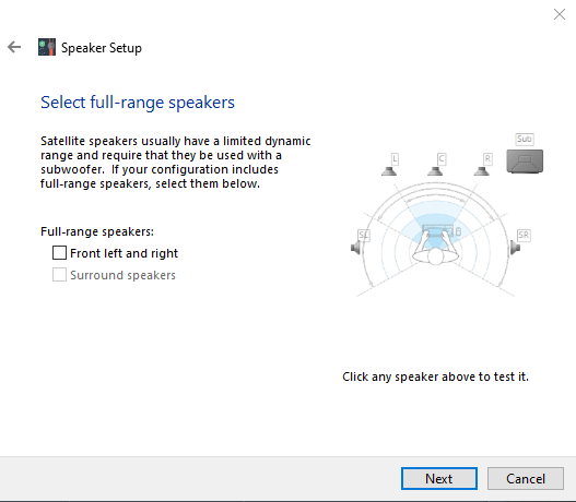

alex4vba wrote: Tue Mar 09, 2021 2:52 pm Yeah thats indeed surprising, I am glad I found that out once more reaching out to you guys, really appreciate it...
Ahh this one is easier :)
In the sound control panel, you can select your HDMI device and click the button on the bottom left labelled 'Configure'
The first screen will be "Choose your configuration" and you probably already have "5.1 surround" selected in the list on the left (you will see a graphic on the right displaying the configuration), Now you can click 'Next' to confirm it. Note there may be multiple arrangements for your outputs, Eg I have two "5.1 Surround" options, one with rear speakers and one with side speakers. Choose whatever is most accurate for your setup.
The next screen is "Customise your configuration" and you will have check-boxes for each of the speaker types (Eg Centre, Subwoofer and Side Pair). Check them as appropriate for your configuration. Then click 'Next' to confirm.
The next page is the one you want, "Select full-range speakers". Check them as appropriate for your configuration. If you have limited-range satellite type speakers and there is too much bass, make sure those speakers are not ticked here. Speakers which are ticked are full-range and get all of the bass, speakers which are limited range get only mid-to-high frequency sound (leaving the low frequency/bass for the subwoofer and full-range speakers). Click 'Next' and then if you are satisfied everything was correct click 'Finish' and you are done.

Ok I looked up the configuration and it was all ticked... so I disabled both but somehow that did not really made a difference... :)
2021-03-11 18_16_02-Speaker Setup.png (25.02 KiB) Viewed 19476 times
But the stereo repeat option is korrekt?
2021-03-11 18_16_54-VoiceMeeter.png (16.64 KiB) Viewed 19476 times

I wouldn't use the Stereo Repeat function here. I would just use normal mode. Stereo audio will play in stereo, surround will play in surround.
The manual https://vb-audio.com/Voicemeeter/Voicem ... Manual.pdf on page 20-22 has all the info you need about which mode does what.
