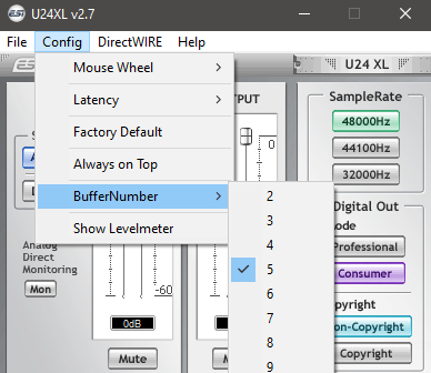

Finally in my audio interface's software I can apart from the latency also set the buffer number but I have no clue what this is and didn't find anything in the manual either. Right now it is set to 5.

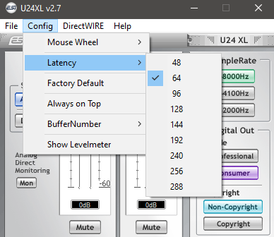

Banana Bread wrote:Finally in my audio interface's software I can apart from the latency also set the buffer number but I have no clue what this is and didn't find anything in the manual either. Right now it is set to 5.
The audio interface manual states: "For recording applications, a typical latency buffer size between 4 and 8ms is standard". ¿Could it be set to 5ms? ¿Could you please provide a screenshot?

Andres wrote:The audio interface manual states: "For recording applications, a typical latency buffer size between 4 and 8ms is standard". ¿Could it be set to 5ms? ¿Could you please provide a screenshot?
I don't quite get what the buffer number is.

However I still don't get what the BufferNumber in my interface's software is supposed to do.
Posts: 2184
Re: Question about Virtual AUX ASIO
normally 2 buffer is enough to manage ASIO interface... you may increase it if getting some discontinuity in the sound of your DAW.
