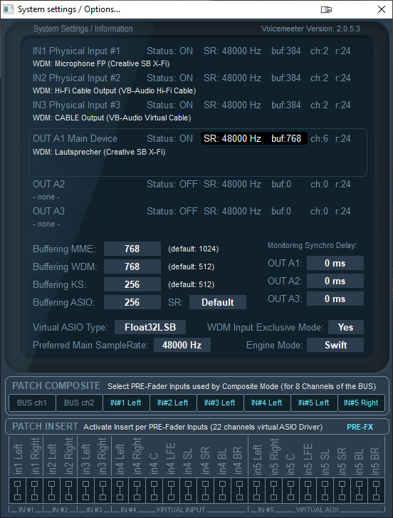

To add to my initial post, here are my VoiceMeeter system settings. https://imgur.com/a/2P89Lxq
VoiceMeeter settings - Imgur.png (76.18 KiB) Viewed 8481 times
I tried to use also the ASIO for my A1 Creative SB X-Fi, but I couldn't manage to make it work that well, also within the latency settings. I might not yet understand these appropriately.
Can someone help me with the settings and this particular sound card to make the card's features work again? Is it maybe due to the 'WDM Input Exclusive Mode'?

Hi. ¿Could you try using the MME option for your speakers on A1 Hardware Input? Please also set WDM Input Exclusive Mode to No. The recommended value for the Engine Mode is Normal.

I tried both ideas, but they didn't give the hoped result. I had set up these options of Exclusive Mode and Engine Mode to reduce the perceived delay as best as possible without noise issues.
So I deinstalled and reinstalled the newest VoiceMeeter version (2.0.5.8), where I noticed the WDM Input Exclusive Mode as well as the Engine Mode to be deactivated, but still showing "Yes" and "Swift" respectively.
I then used the "Reset Settings (Re-Initialization)" option, which reset both settings to "No" and "Normal". (Where are these settings saved? They don't seem to be in the saveable xml file.)
