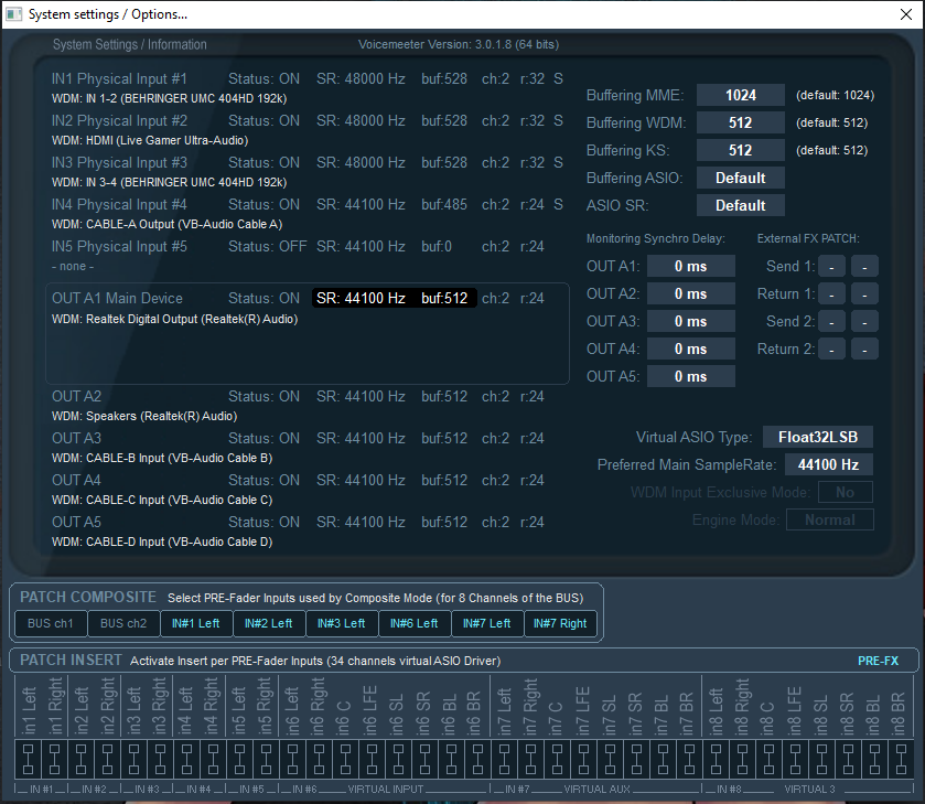

Hi. A general recommendation to avoid choppy audio is to select a physical device at Hardware Out A1 (like MME: Speakers or a headset); A1 is Voicemeeter main device so when possible use a physical device. You can also share a Voicemeeter **Menu > System Settings / Options...** window screenshot to take a look.

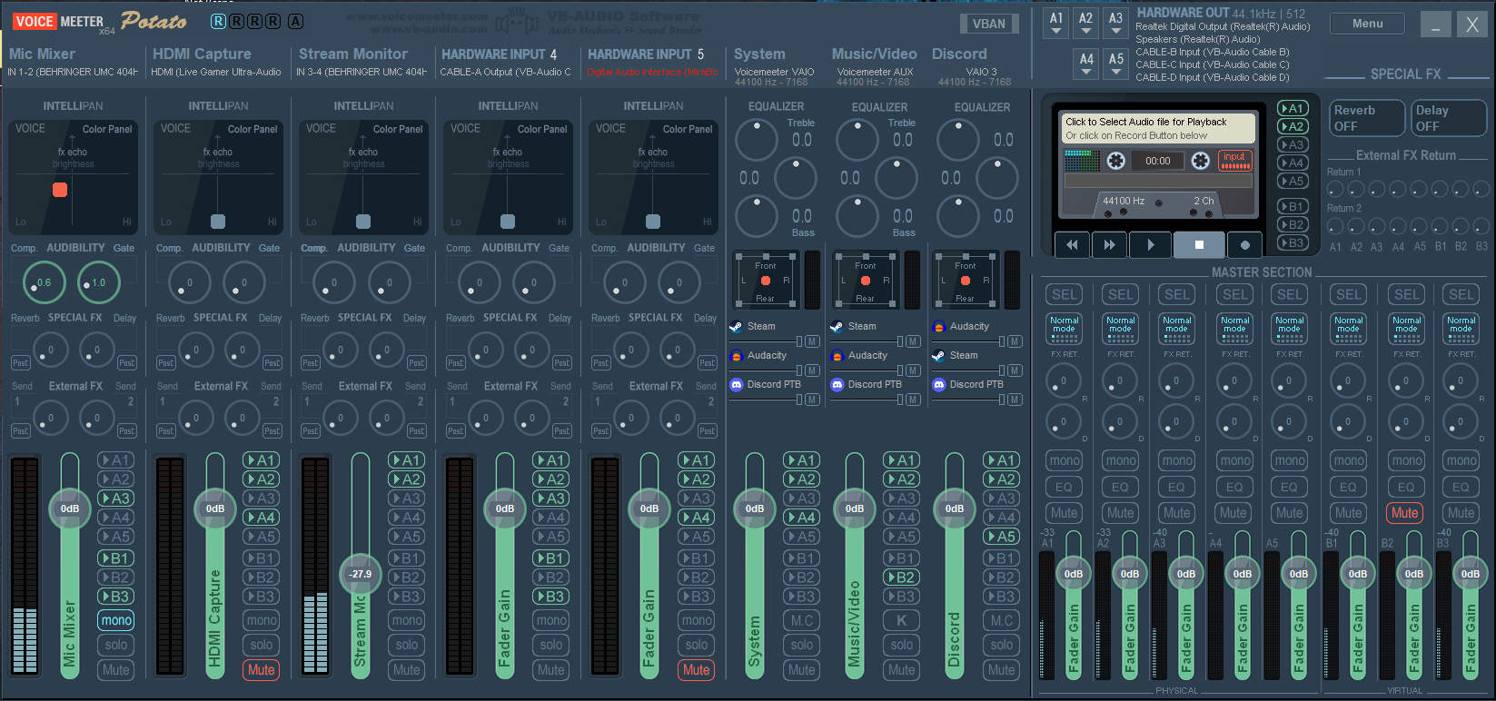

So, basically the Virtual Cables are not a good output for VoiceMeeter. Below is a screen shot of the data requested, the VoiceMeeter setup, and an Image showing the audio.

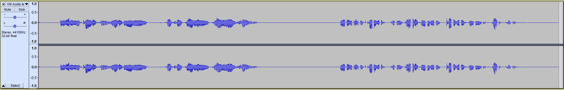

Here is an image of the audio. The first half is using the VoiceMeeter VAIO output into Audacity. The second half is through a Virtual Cable into Audacity.

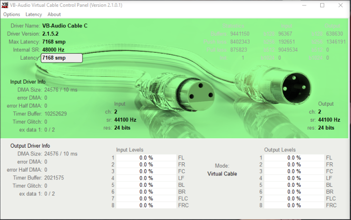

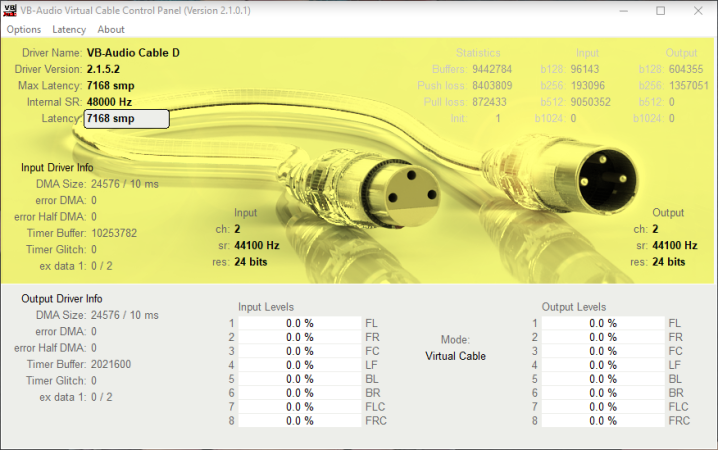

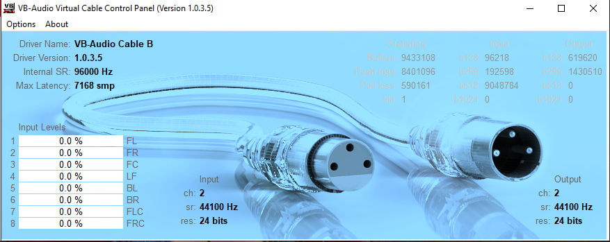

Looking at the control panels, it looks like they are already set to the Max Latency (not sure if this is the Internal latency) of 7168 and the output Sample Rate is 44100 Hz.
Cable D.PNG (228.79 KiB) Viewed 70229 times
The system only allows me to have 3 attachments and it was too big in size to upload one image of all 4 (it would have to be small to were you almost can't read it.

The first virtual audio cable control panel shows and internal samplerate at 96 kHz, please set it to 44100 or 48000:
1- run the control panel in administrator mode
2- change the internal SR (by the menu).
3- Reboot.
Audacity can use big buffer and reducing the internal samplerate in the VB-CABLE naturally increase the internal buffer size:
7168 sample at 44.1 kHz pipe is storing more than 2 time more samples than in a 7168 sample at 96 kHz pipe.
