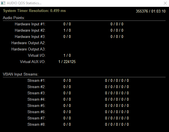

Could you click on black field "SR : 48000 buf : 512" to open the AUDIO QOS Statistics dialog box and post a screenshot ?

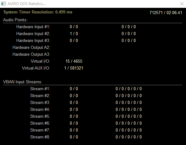

For sure, thanks Vincent. 2 images, first from after 1h, second after 2.
I've been testing for 2h trying to recreate the error but couldn't, a day ago I changed audiodg.exe from task manager and set affinity to CPU 1 (I saw some other posts online), I know that shouldn't be doing nothing relevant but maybe is helping? Will update in some days. In case I have more errors I will try to check CPU peaks with ProcessExplorer.
Thanks again for the reply

if you cannot link the crackling to CPU activity (when playing to your game), You can maybe try to set the System Timer Resolution back to 1ms (instead of 0.499 on your screenshot) in Voicemeeter since some gamers already told us this could disturb audio in some cases with some games...
to do so, create a DWORD Value “TimerResolution” to '1' in Voicemeeter registry key: Computer\HKEY_CURRENT_USER\VB-Audio\VoiceMeeter
restart Voicemeeter (or your computer if not enough).
check if it fix your problem and let me know...
