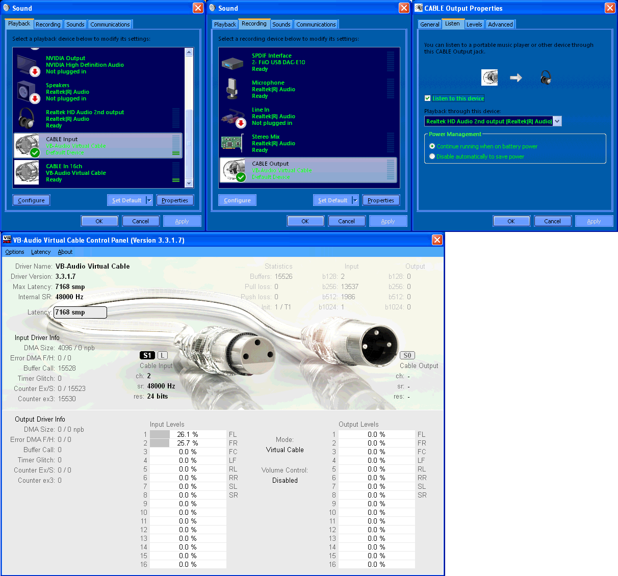

could you post screenshot of your VBCABLE control panel for example ?

Vincent Burel wrote: Wed Aug 20, 2025 7:28 pm could you post screenshot of your VBCABLE control panel for example ?
Certainly!

seems to be normal, but you have nothing connected to the VB-CABLE output and your listen option makes no sens.
if you want to listen the recording device (VB-CABLE output), you must route it to a physical device (not to VB-CABLE input again, since it is your default playback device).

Vincent Burel wrote: Wed Aug 27, 2025 9:00 am seems to be normal, but you have nothing connected to the VB-CABLE output and your listen option makes no sens.
I tried that, it didn't change anything.
You said it seems to be normal, but it clearly isn't. Can you help me troubleshoot this?

change your listen option to route the VBACALE output to your physical speaker or headphone.
post a screenshot of the CABLE output properties dialog box, to let me see.

by OnlyOne
Tried that.
VB screenshots2.png (161.18 KiB) Viewed 87162 times
Interestingly, after updating my drivers I now see Stereo Mix as a recording device, but tragically it doesn't work. This is why your program is so important.
