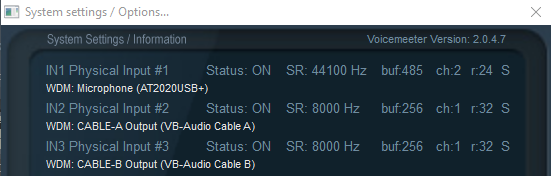

Been in contact on email and tried all their fixes (setting it to 44100hz in windows sound settings) but nothing has been working. Problem started after reinstalling windows completely and at the same virtual audio cable and voice meeter.
Screenshot of Cable control panel and voicemeeter. https://gyazo.com/9d88c1ab9f1e04b457ff2932bfc300e1

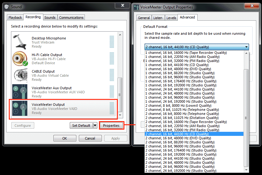

you may reset the default format in the Windows Control Panel / Sound Dialog box.

Already tried reseting everything to defaults and changing from 44100hz to 8000hz and back to 441000hz but still says 8000hz in voicemeeter and cable control panel, plus obviously sounds awful.

you may change the default audio format to 44100 Hz or 48 kHz
(for all recording devices that could have been impacted by the November WIN10 upgrade - or after having installed audio driver on WIN10 version 1809).
Then Reboot and recheck your recording device default audio format.

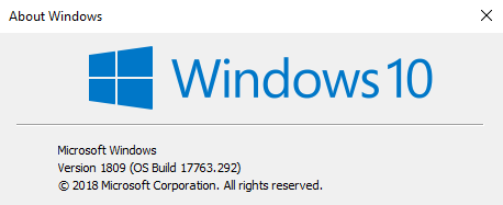

Posted: Wed Jan 23, 2019 8:32 am
It seems this "8000Hz" problem has been fixed as part of KB4476976 (OS Build 17763.292):
https://support.microsoft.com/en-us/hel ... Vh00m_QaJs
- Addresses an audio compatibility issue when playing newer games with 3D Spatial Audio mode enabled through multichannel audio devices or Windows Sonic for Headphones.
- Addresses an issue that may cause audio playback to stop responding when playing Free Lossless Audio Codec (FLAC) audio content after using a Seek operation such as rewind.
- Addresses an issue with two-way audio that occurs during phone calls for some Bluetooth headsets.

I've installed the latest Windows 10 update:

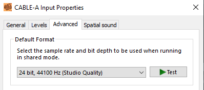

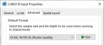

I have Cables A and B set up as 44k Hz audio:
cable a.png (8.24 KiB) Viewed 54665 times
cable b.png (8.87 KiB) Viewed 54665 times
And the result is still the two cables showing up as 8k Hz capable. (seems I can only attach 3 images, so I'll reply to show what MEETER is reporting to me.

As we explained, this is concerning recording devices, not playback devices.
so you may check the default format used by the cable output (not the input).
