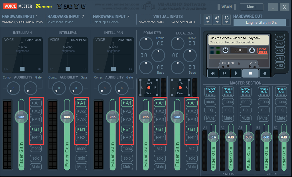

Hello there,
i'd like to link my M.I.D.I. device (Krog nanoControl Studio) to the Channels (A1/A2/A3/B1/B2) for each Input (like in the screenshot)
is that possible ?
Greetings from Germany,
Michelle
Re: Link M.I.D.I Hardware to Channel
Posted: Sat Feb 16, 2019 12:12 pm
you cannot do that directly by the MIDI-Mapping...
but with the MacroButton app (installed with Voicemeeter).
Macrobuttons can also react according MIDI message coming from the MIDI device connected to Voicemeeter.
and then change any control by script:
example:
Strip(i).A1=1; //1= ON / 0 = OFF
Strip(i).A2=1;
Strip(i).A3=1;
Strip(i).B1=1;
Strip(i).B2=1;

//Solved by Strip[0].gain+=5;
oh great. found the documentation for the macro-buttons :)
but cant find one option:
Is it possible to said:
Strip(0).gain=(+)6.0;
so that the program adds 6DB to the slider (for example: Its at -12db, you press the button and than it switches to -6db)
Posted: Sat Feb 16, 2019 1:47 pm
yes, normally this syntax should work:
Strip(0).gain +=6.0;
