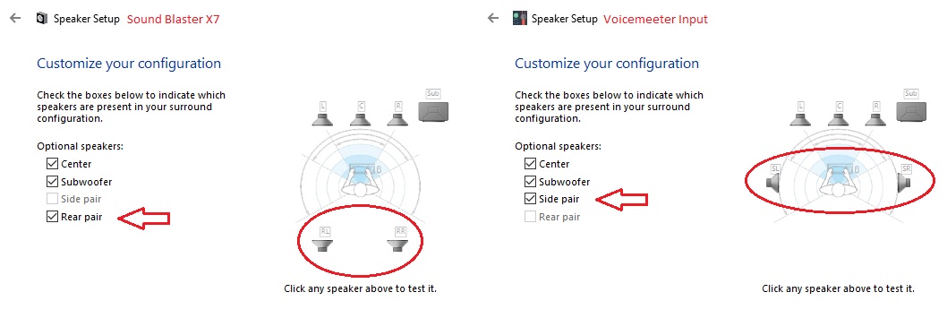

I will try to investigate further and see if there is a conflict with the audio device but in the meantime I have a new question regarding 5.1 (cf. attached image). For my device the speakers are at the rear and for Voicemeeter the speakers are at the side. Is there any way to be able to check the proper box in order to have the same speaker configuration as my device? I'm afraid surround won't work properly otherwise.

Voicemeeter virtual input can be set in 7.1 mode instead of 5.1 to let you select rear setup maybe..

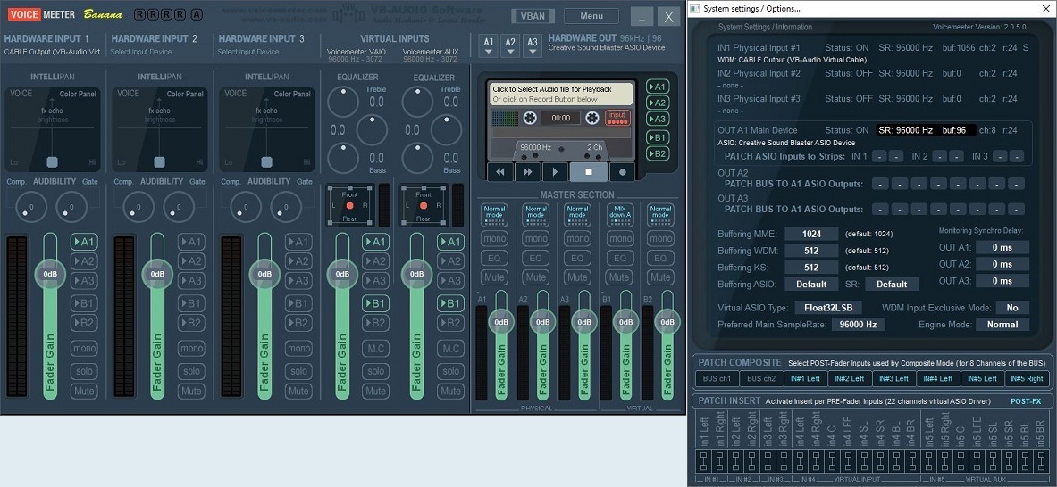

by AirMax95s
Here is the screenshot you requested:
Please let me know if I set anything wrong and how to solve the 5.1 channels being mixed up.
Also regarding 5.1, I found this thread: viewtopic.php?t=491#p1276
Yaun wrote:When I set to 5.1 it seems the audio is played by the correct speakers (BR, BL). I think it's only shown the wrong way in Windows Sound
I can confirm this but could it have any negative impact on the surround virtualization effect?
Thanks for your help.
Re: Switching to ASIO driver causes Voicemeeter Banana to freeze
Posted: Sun Jan 19, 2020 6:04 pm
96 samples buffer at 96 kHz is susrely too small to warrant a stable stream.
you may tweak your ASIO device control panel to get around 256 or 512 samples buffer size on your output A1 device = main voicemeeter stream
